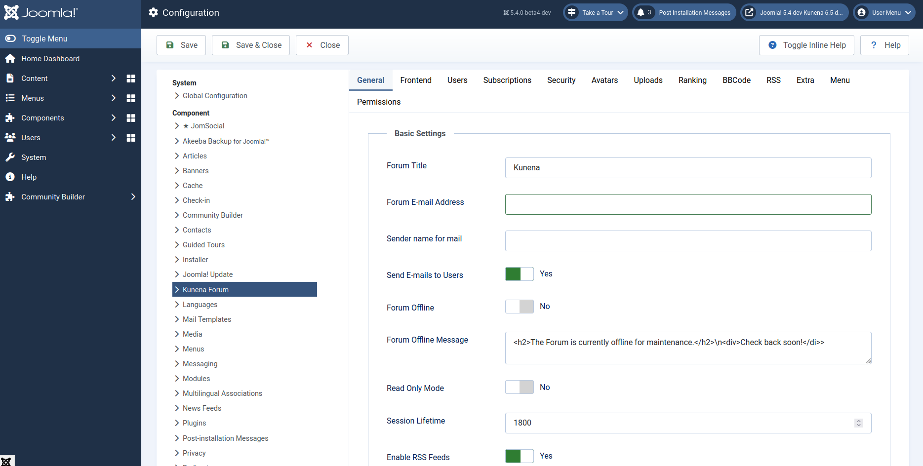

Ok, one thing that is already long time on my wish list is the Kunena Configuration.
This is implemented as a view (with model and controller), the reason is probably due to limitations in the past.
I would like to convert that to 'real' component options like every other component in Joomla has.
The functionality of how the config options will be used in the code will remain the same using the KunenaConfig class, so no changes needed there.
This would make the developers life a lot easier:
  • new users expect configuration under options
  • functionality is build upon core joomla default config.xml
  • adding an option is as simple as adding a field, no more adding things in multiple places in the config MVC (and no more deprecated messages when missed a setting)
  • a lot of code can then be removed, making maintenance easier
  • etc.
Using JS we could even have the current functionality of highlighting fields whose value is not the same as the default value.
This is a lot of work, but doable before 7.0 release.
Is that something I can pursue or am I the only one who would like to have this / are there other reasons I do not know why we do not do it this way?

1 year 2 months ago #233988 by Leen
Replied by Leen on topic Joomla 6 support?
I would like to have this now you only see the rights.
With kind regards
Leen
