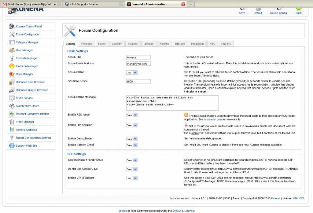

I'm currently using blue host. My configurations are only barley changed from the default which in the first tab (general) can be seen here:
