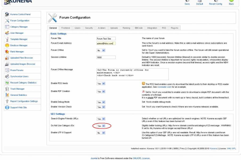

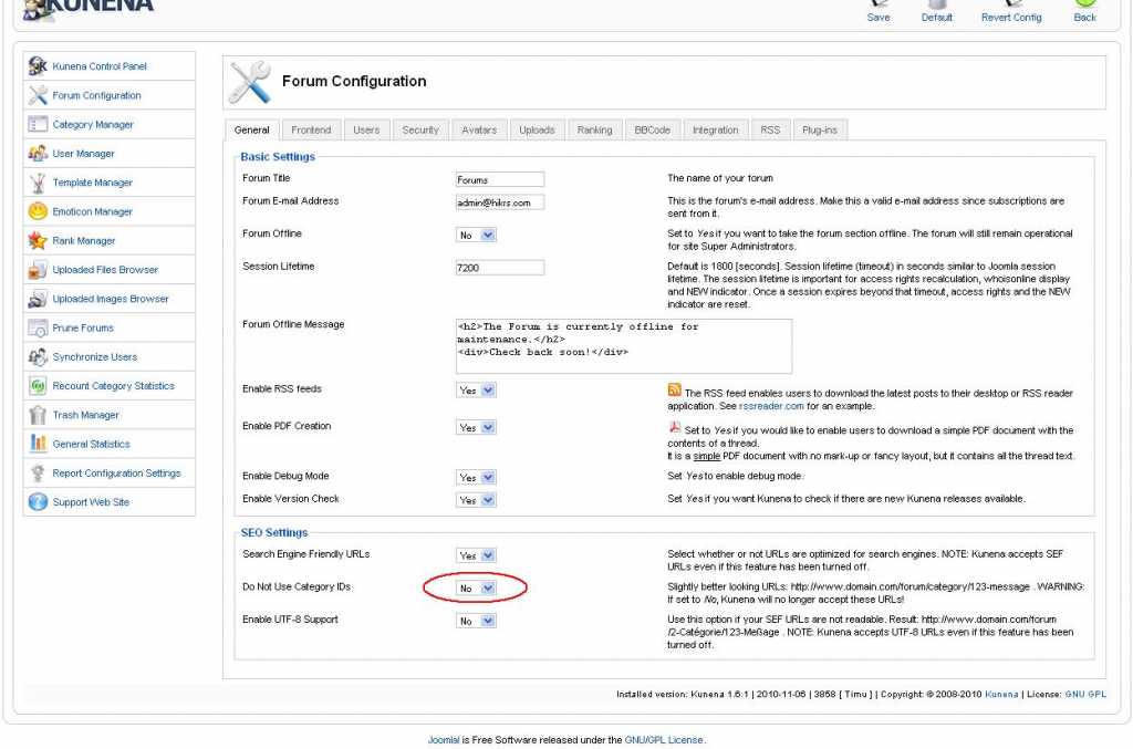

My main site forums don't load that slow (although between 1-1.5 seconds depending) hikrs.com/forums
But notice this screen shot of the configurations (This is of my main site with faster loading time but not as good looking urls)
Getting rid of the numbers in the url makes all the difference.
On my test site hikrs.com/freshinstall/forum it has slightly nicer urls because of the config as seen here:
They both are almost exactly the same except for one option, and guess what, the test site forums is way slower as a result. So the problem is not too many categories, but when you have too many categories with the "Do not use Category ids" that it becomes a problem.
System Plugin sef makes no difference, tried both on and off and they load at the same speed.
Also disabled almost every plugin (except for authentication user and such) also disabled much of the kunena stuff which seemed to slightly increase the loading speed but not by much. Turned off all debug modes, rss, pdf, and even plugin kunena which still it has this problem.
Last edit: 15 years 11 months ago by Josh.

Josh wrote: So the problem is not too many categories, but when you have too many categories with the "Do not use Category ids" that it becomes a problem.
Yes, we concur with that conclusion.
