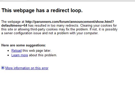

15 years 11 months ago #77984 by Maxoutje
Replied by Maxoutje on topic Re: ERR_TOO_MANY_REDIRECTS
Could anyone help me out this matter pleaseeee ?
15 years 11 months ago #78012 by @quila
Replied by @quila on topic Re: ERR_TOO_MANY_REDIRECTS
in Joomla configuration enable Debug System, set "Error Reporting" to Maximum, in Kunena Configuration set to Yes "Enable Debug Mode", then run your site and post here if you see some error.
Regards
15 years 11 months ago - 15 years 11 months ago #78128 by Maxoutje
@quila wrote: Hi,
Regards
Nothing is working at all ! i see when everywhere codes on my site when i enable this debug system
:S This is really a problem, i have this problem on my 3websites
Last edit: 15 years 11 months ago by Maxoutje.
15 years 11 months ago - 15 years 11 months ago #78134 by Maxoutje
Maxoutje wrote:
@quila wrote: Hi,
Regards
Fizmatik wrote:
sozzled wrote: You need to work your way through every menu that you have on your website.
Here is a possible way to resolve the matter. Work through every menu on your site. Trash every menu that has anything to do with your forum (all menu items that have anything to do with your forum). Then, permanently delete everything in your menu trash. After that, go to the Kunena control panel and use the Create Menu function. That's it; do nothing else. Now check to see if you can now access your Kunena forum from your front end. Don't try to do anything else fancy, please report back if this works. If it doesn't work then there are other possibilities, but let's try the "default approach" first.
I find this solution !! :) and it worked for me
15 years 11 months ago #78186 by parunner
Replied by parunner on topic Redirect problem
I am new to Kunena and joomla. I have installed Kunena on my website, but when trying to navigate an error comes up about a redirect loop.
15 years 11 months ago #78196 by xillibit
Replied by xillibit on topic Re: Redirect problem
Can-you put here please the kunena report configuration settings ?
