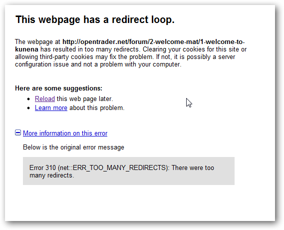

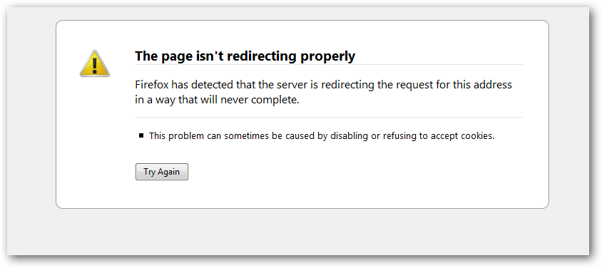

i was wondering if this was something going on with my host cuz ive never had this issue till the last couple of hours.. i can get to my forum and see profiles, recent posts, etc.. what i cant do is get into the "welcome mat" or "suggestion box" categories on a default install nor can i get into the threads under "recent topics" even tho i can see them.. here are the errors the chrome and firefox are giving me:

madLyfe: I think that you'll find this topic - that I have merged your post with - will address your question better. ;)

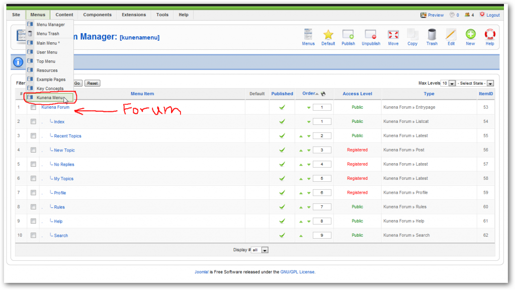

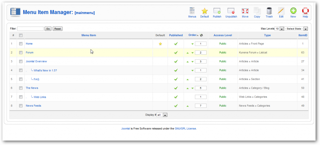

this is the problem.. i installed joomla and kunena freshly.. when kunena installs it creates a "Forum" menu item under the "Main Menu". shown below..
also when kunena is installed it creates a whole new menu called "Kunena Menu".. in this menu the first menu item is "Forum" which conflicts with the menu item "Forum" that is located in the "Main Menu".. thus you just have to rename one of them to something else, like "Kunena Forum" like i did in th picture below:
still dont understand it all but thats the way around it..

This sometimes happens if the Joomla template does not have a "main menu" item for Kunena. If, for example, you have a menu called mainmenu that does not have a Kunena menu item then, when you use the Create Menu function, you can create an item for Kunena in this mainmenu menu. Similarly, when you install Kunena, the installation process will try to find if there already exists a menu item in the mainmenu menu and, if there isn't one there, it will create one. It's when you have two different menu items for Kunena, both having the same [alias] name, that causes redirect loop problems.
There are two schools of thought on this issue. One view is that it's better for the Kunena installation procedure to create a menu item (if one doesn't exist, of course) somewhere. But where, specifically, should that somewhere be? The answer is to try to put this menu item into the mainmenu menu because that's the most likely place that people will want to put a link to their forum. But what if they've already got a link somewhere else?
The other view is that it's safer if the installation procedure does not not create a menu item anywhere and leave that choice to the person who is installing Kunena. Of course that means this forum will be flooded with the inevitable "How do I create a menu link to Kunena?" question.
So, as you see, there's no simple answer to this dilemma.
In your case you already have a link to Kunena somewhere on your website, but not in the mainmenu menu. Therefore when you upgrade Kunena you get another menu item created, but the existing menu link still exists and then you get redirect loop issues.
In my own case - because I use really simple Joomla templates and, most of the time, I use default installations of software, I don't experience these issues. On one of my test websites I have performed about 20 Kunena upgrades and, in each case, the upgrade has not attempted to add a new menu link. Like most things in Joomla, it's a case of being aware of how things work and, if you want to do things in your own way, then you need to pay special attention to some things.
The Joomla's flexibility is both a blessing and a curse. Fortunately, in this last case just described, madLyfe has discovered the answer and has posted details of the workaround that has solved his problems. All that I've done is to try to provide an explanation to help others understand why these things happen. B)
