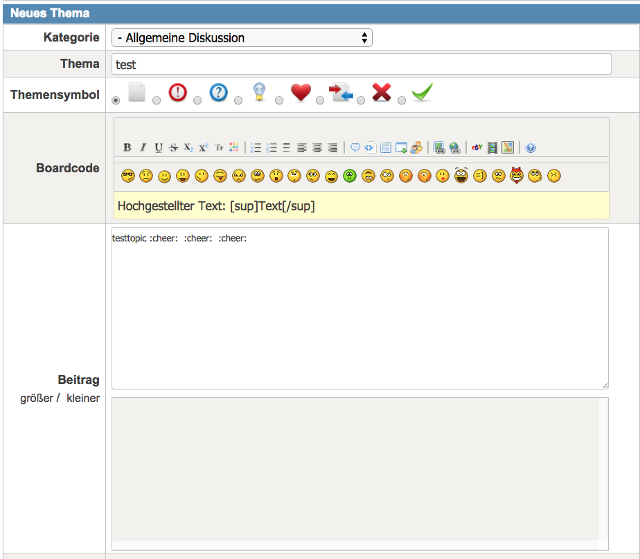

See attached screenshot.
Can You help me ?
Bye, Torsten...
