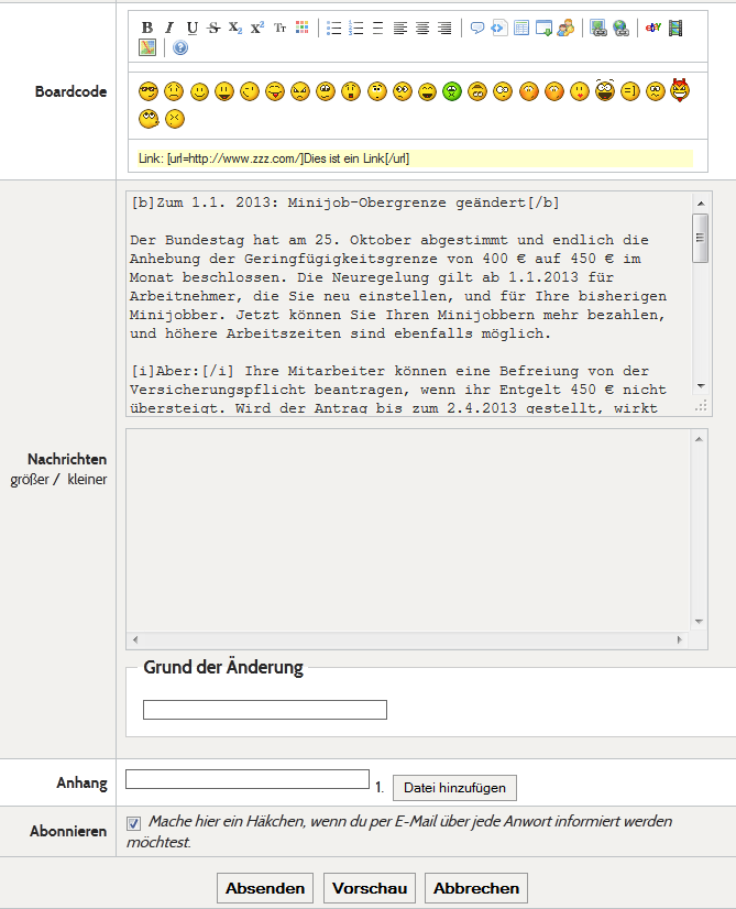

Solved K 2.0.2, K 2.0.3: problems with preview

(1) To implement Joomla SEO exactly as I described it in the Wiki. In other words, do not use HTML suffix, and use a vanilla-flavoured .htaccess file.
(2) Install CB 1.9RC.

Not necessary to install CB 1.9RC, only "do not use html suffix" in Joomla SEO configuration.
I hope the K 2.0.3 will fix the the problem.

1) An AlphaUserPoints update is available of late and waiting, but I don't think that AUP is causing this ...
2) I've updated MobileJoomla since my last K posting, but I don't think this affects any "Desktop" pages ...
3) media/system/js/modal.js (and modal.css) is NOT loaded,
mootools-core.js
mootools-more.js
core.js
/media/system/js/mediaboxAdv-min.js and
/media/system/js/default-min.js ARE on all Kunena pages,
/media/system/js/validate.js and
.../template/.../js/editor-min.js (and poll...) ONLY in editing mode.
As I have no idea whether the modal library is needed or not, I've "manually" called <script src="/media/system/js/modal.js" type="text/javascript"></script> ... same result
4) sozzled said:
Actually I'm a Joomlapolis 'Pro', but 1.9 seems to be not available. In addition, the problem did NOT occur with K 2.0.1 and CB 1.8.1 before. And anyway, I'd really like to wait with this "huge task" of updating CB/GJ and all related stuff until any extensions are stable - if possible.There is a defect in CB 1.8.1 that affects Kunena. This defect is fixed in CB 1.9; the defect relates to the message preview going "blank" and, therefore this CB problem may be responsible for the issues ...

Please heeeelp!
You have not given us any real information that allows us to help. I have therefore merged your question with another topic that may give you some help. Perhaps the answer you are looking for Iain here?parslej wrote: I have just upgraded frm v. 1.7 to 2.0.2 and noticed preview doesnt work.
