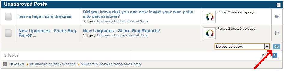

When I click on the unapproved posts link, and see a list of posts to moderate, it gives you the option of checking the box next to each post, and below that, choosing an action, such as "Approve Selected", "Delete Selected", etc. I am able to select the option I want, but the "Go" button is unresponsive. It changes color but does nothing when clicked.
I've attached a screenshot:

Very interesting. I haven't personally checked this myself and yours is the first report we've seen about the Go button not working. This is unusual because, K 2.0.2 has been out for a while.
This may be a general problem - and other people who use the feature may like to comment - or this may be a problem specific to your website. It's highly likely that the Go button, like so many buttons in HTML, requires a Javascript function to be run before processing the request. If Javascript is not working on your browser, or if your site has a Javascript library that's clobbering Kunena, this would explain why the function is not running in your case. This means that you would need to look to see what other Javascript libraries are being loaded on your site.
If my suspicions are correct, your problem is somewhat like the many that are discussed in msg #1 of Before you post your question, read this first .
Further information from you may assist us to nail down the cause of your problem. See the important notice at the top of this page which shows you how to provide us with that extra information.
