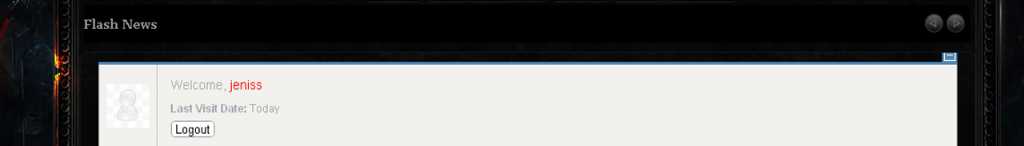

Replied by jeniss on topic Problem with tabs(can't see them)
