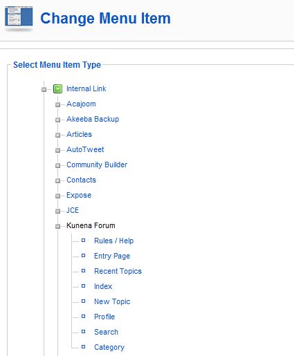

When I click that menuitem I can choose the following:

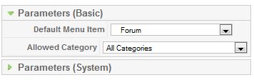

I then changed it to entrypage. After that I can change:
I doesn't matter what i choose. I always will be redirected to the index page.
