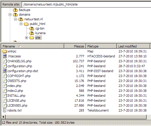

The screenshot you see is the toplevel directory. It only has 1 file in it that is a redirect to the /site directory. You can also see the other directory/installation called kunena.

I want to see a list of files in the top-level folder of your Joomla website. A standard Joomla website has about 14 files and 15 folders. Some of the files in your top-level folder are:
CHANGELOG.php
configuration.php
COPYRIGHT.php
CREDITS.php
index.php
index2.php
robots.txt
I would like to see a picture of the list of your files, please.
16 years 4 months ago #54235 by Hurr1c4n3
Replied by Hurr1c4n3 on topic Re: Links don't work
Here ya go mate
16 years 4 months ago #54240 by sozzled
Replied by sozzled on topic Re: Links don't work
Thank you. There's something peculiar about that .htaccess file. In your case, the file size of your .htaccess file (2777 bytes) is different to the standard, unmodified J! 1.5.20 htaccess.txt file (2773 bytes). I wonder, if it's been changed or is corrupted ... or maybe it doesn't work at all with your webserver software? I'm just guessing. There has to be a reason why SEO/SEF URLs are messing with your installation of Kunena.
