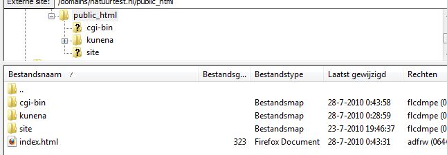

It might also be helpful if you could post a screenshot of the files listed in your site root folder, too, please.
16 years 4 months ago - 16 years 4 months ago #54168 by Hurr1c4n3
Replied by Hurr1c4n3 on topic Re: Links don't work
I'll see what I can do.
I installed a fresh Joomla and kunena beta1 on the same server and here everything workes OK.
www.natuurtest.nl/kunena
Setting www.natuurtest.nl/kunena :
Legacy mode: Disabled | Joomla! SEF: Enabled | Joomla! SEF rewrite: Enabled | FTP layer: Disabled | htaccess: Exists | PHP environment: Max execution time: 30 seconds | Max execution memory: 128M | Max file upload: 8M
Kunena version detailled: Installed version: 1.6.0-BETA1 | Build: 3068 | Version name: | Kunena detailled configuration:
Settings www.natuurtest.nl/site
Database collation check: jos_kunena_categories have wrong collation of type utf8_bin on field moderators jos_kunena_messages have wrong collation of type utf8_bin on field ip jos_kunena_smileys have wrong collation of type utf8_bin on field code jos_kunena_smileys have wrong collation of type utf8_bin on field location jos_kunena_smileys have wrong collation of type utf8_bin on field greylocation jos_kunena_users have wrong collation of type utf8_bin on field view jos_kunena_users have wrong collation of type utf8_bin on field avatar
Only a index.html with a redirect to the /site directory
Last edit: 16 years 4 months ago by Hurr1c4n3. Reason: Added settings new install
16 years 4 months ago #54171 by sozzled
Replied by sozzled on topic Re: Links don't work
Thank you. The collation method you have used for your Joomla/Kunena SQL tables seems to be a problem. Try changing the collation method to utf8_general_ci.
I would also like to see a listing of the files in the top-level directory of your website www.natuutest.nl (is this the "site" folder in your screenshot?)
Also try experimenting with the Kunena SEF settings, too - try different settings. Please reply with the results from your tests.
