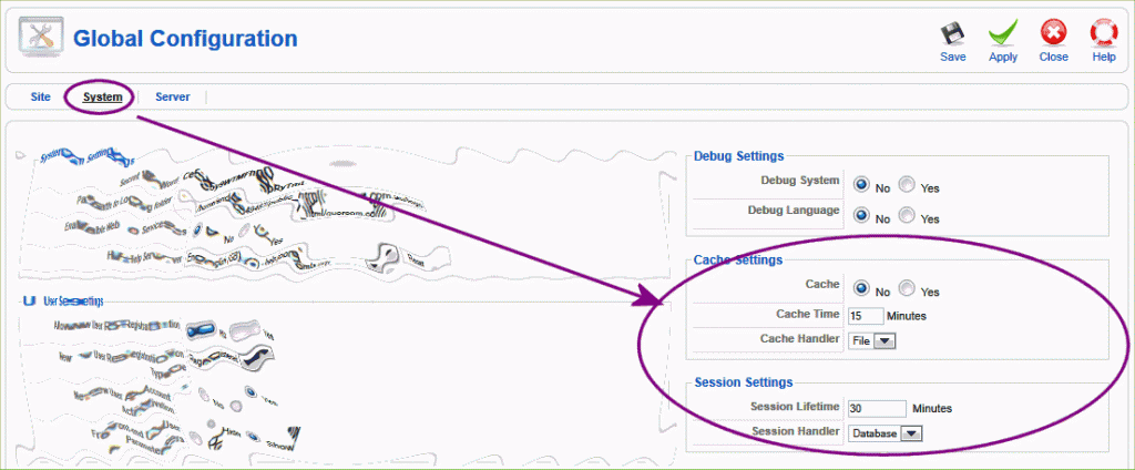

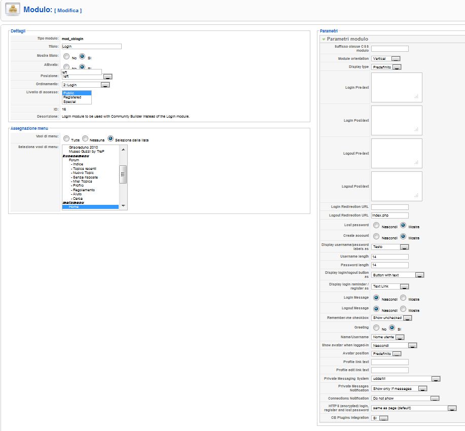

If we have a test account maybe we can see the login redirection problems for ourselves. Have you looked at the mod_cblogin parameters? Maybe a screenshot of your Community Builder login parameters would help?
What are the values of the Global Configuration settings that I have illustrated below?
There is also a known defect in J! 1.5.23 that causes browser pages to not properly refresh when you navigate to pages that you have already visited before. This is another possible cause of things not working (see code.joomla.org/gf/project/joomla/tracke...racker_item_id=25690 )
I am almost 100% certain that this "login issue" - that started 2 months ago - is not something that is caused by Kunena. Why am I so certain? Because Kunena does not have a login module within the basic installation package. Kunena simply uses whatever other, Joomla or third-party extension, login form that you've installed ... but I could be wrong and we need to eliminate all possible doubt.

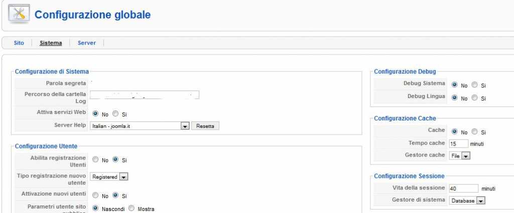

15 years 6 months ago #95949 by nevrastenek
Replied by nevrastenek on topic Re: Login Problem
sozzled many thanks for you work
in a minute i'll send you test account
"login issue" has always been present with earlier versions of Kunena, joomla and CB.
I post now because I hoped to be resolved after updates
