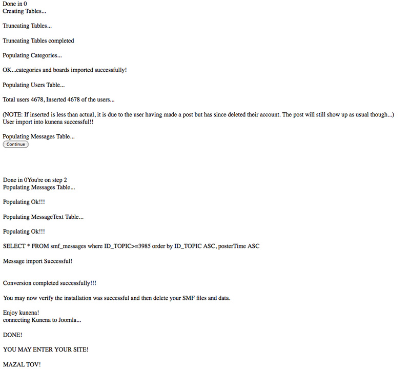

OK, I tried again this morning with a clear brain, but am still getting the short end of the stick. I managed to get some screenshots of the action (Attached).

It's strange though, because on the front end of the forum, I get:
Total Messages: 0 Total Subjects: 0 Total Sections: 6 Total Categories: 27
Let me know if you still want access to the phpMyAdmin.

Ok this is all good, it tells us we have the posts, you need to now go into your Kunena backend and update the post totals etc.
Can I get front-end access to your site, or even admin access to kunena if you want. I dont mind jumping in for a quick look.
