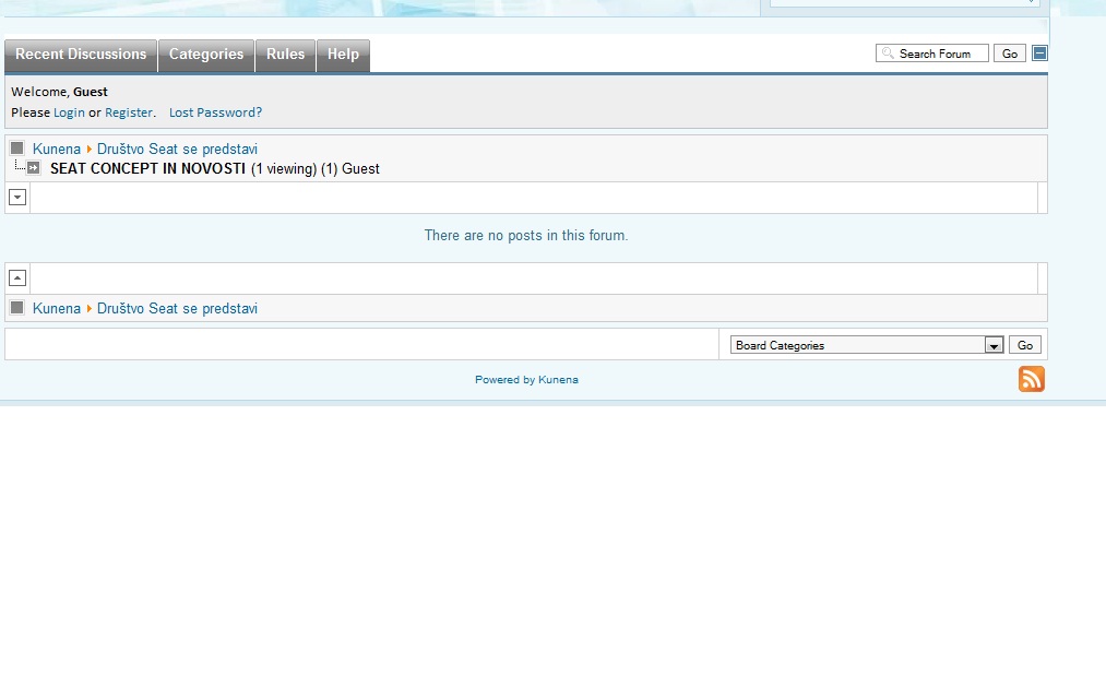

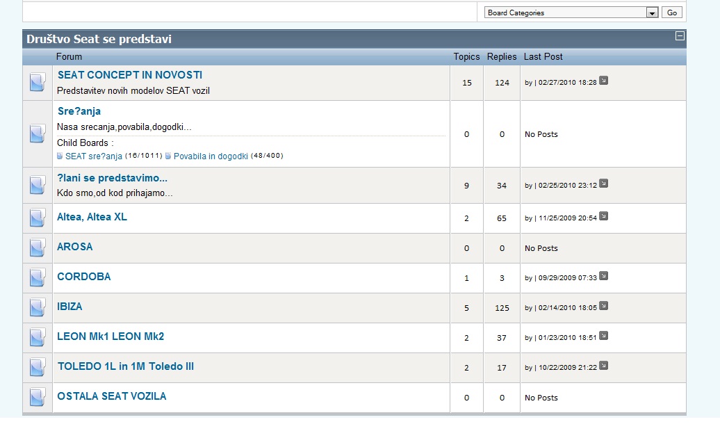

16 years 3 months ago - 16 years 3 months ago #43578 by AntonioP
Here is my problem :)
after abose error :
in kuena forum :
and after clicking on topis to view posts :
and i didn't find ID topic 63 :(
Last edit: 16 years 3 months ago by AntonioP.
16 years 3 months ago #43585 by forum-migrations
Because the error you don't have migrated posts.
I wrote you that try to find the topic title on the other forum, phpbb3 or smf or whatever, search for the character after Akustika v ibiza on the title (because something after that is causing the error), and if is the comma of the fixed line, change the line, if is other character try to modify test.php for replace it using the line as base for fix it.
