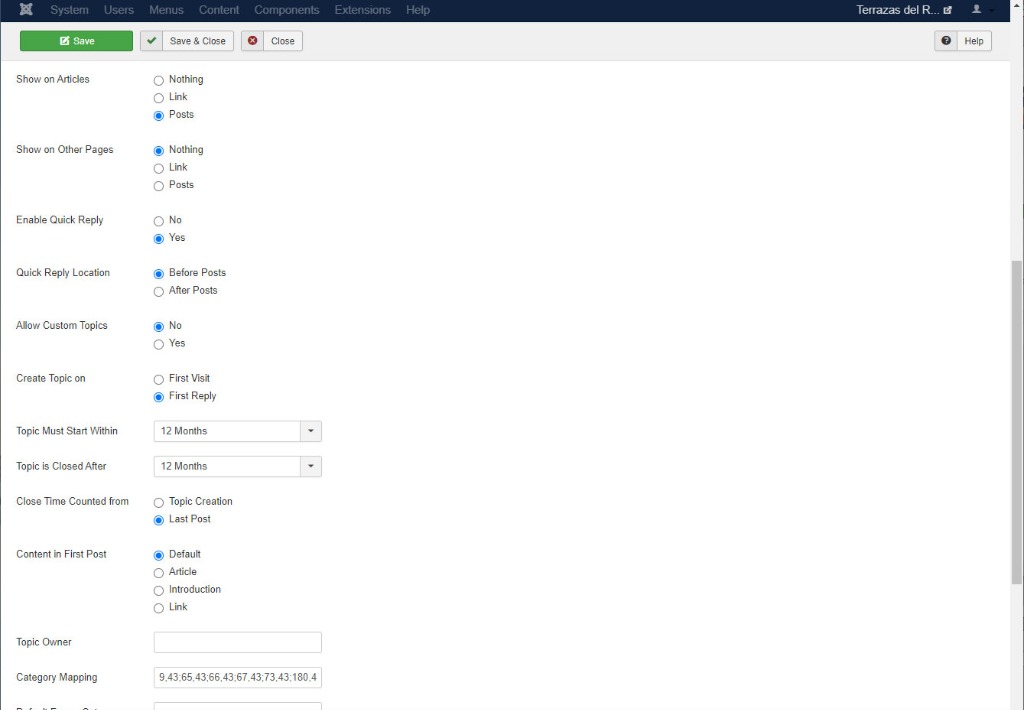

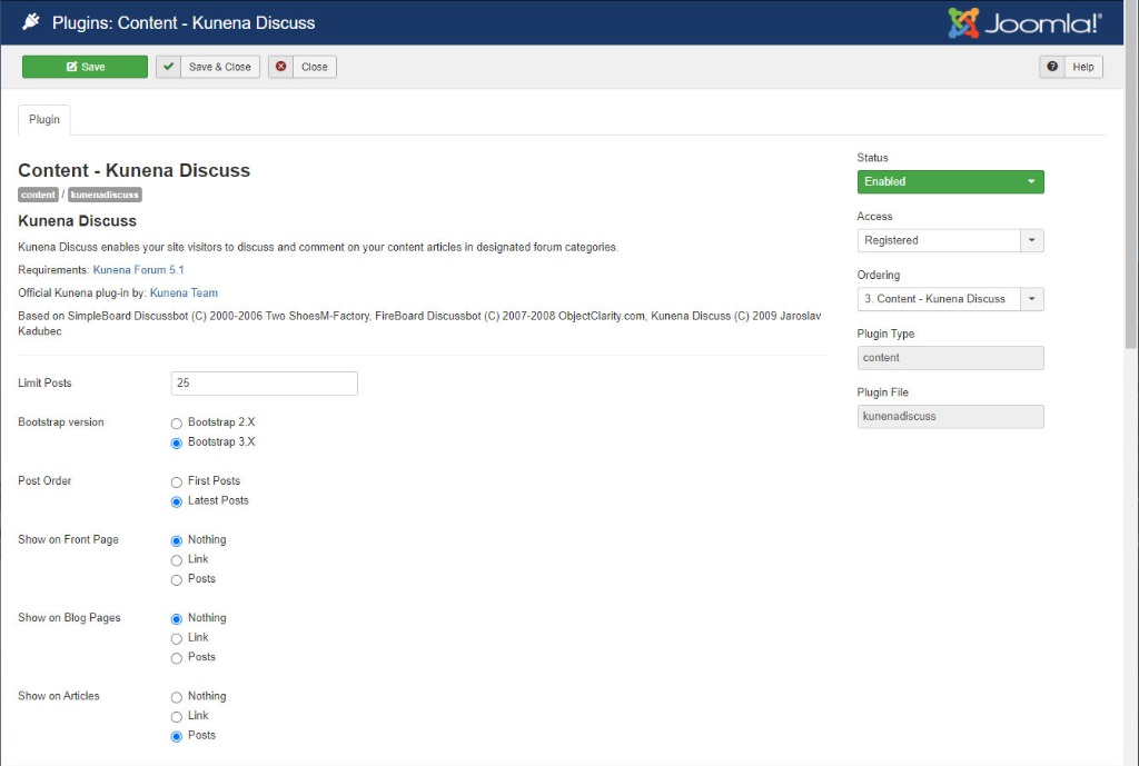

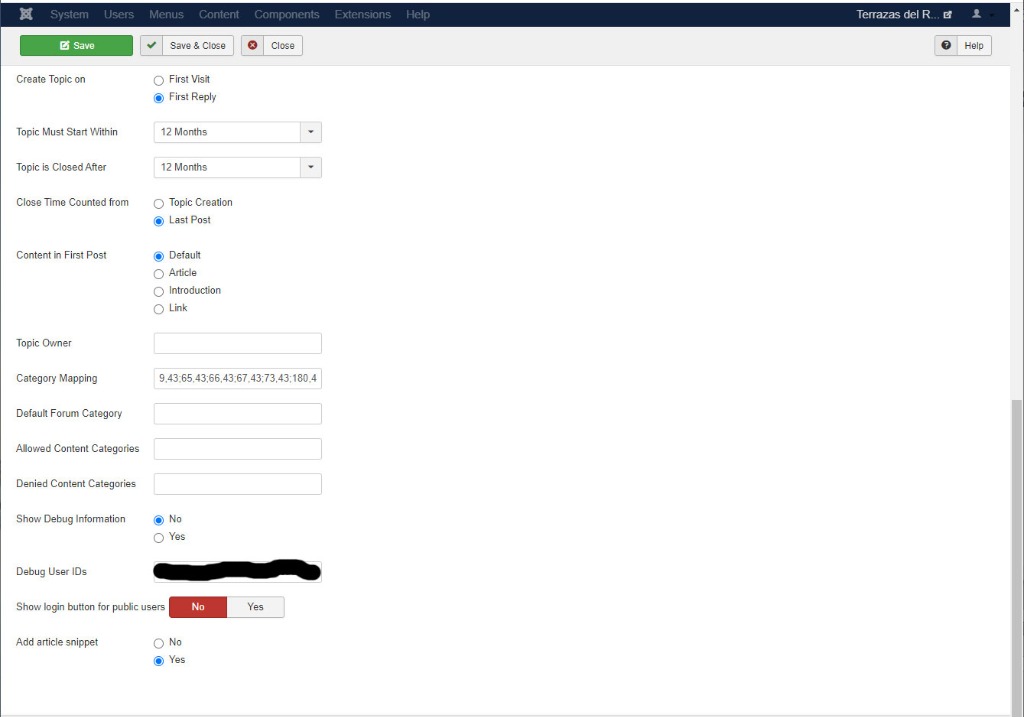

I´m sorry for the delay coming back to you. I didn't notice you reply when it came on the second page, neither did I get an email showing there was a reply. I've marked the checkbox: "Subscribe - Check this box to be notified of replies to this topic.". I think there might be an issue with this subscription.
Here are the screen dumps:
Category Mapping:
9,43;65,43;66,43;67,43;73,43;180,43;193,43;200,43;345,43;62,51;46,51;48,51;56,51;199,51;202,51;11,38;68,38;69,38;70,38;181,38;194,38;201,38;344,38;74,38;63,52;47,52;49,52;57,52;198,52;203,52;12,8;72,8;13,9;71,9;39,117;177,121;191,119;192,118
