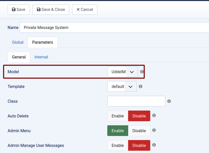

Yes, I had seen in the configuration report that Uddeim is not installed, but it could have been installed earlier and there are still remnants. And yes, the error message is helpful for the developers.
I can now also reproduce this error on my test page. It occurs if you have unpublished the Private Message System plugin in CB -> Plugin Management.
Publish this plugin and the error is gone.
If you do not want to allow the PM feature in the forum, you can use the following setting (see image below) as a workaround in this plugin, because if Uddeim is not installed, there is no PM with it.
Many thanks for your patience. I will add this bug to our bug list.

Brilliant!! That's cracked it. Thank you so much for your patience and support, much appreciated.
