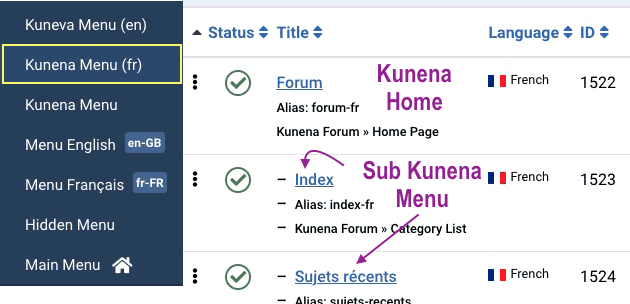

There are no correct destinations in the menu items you have created yourself. The only menu that works correctly is the one created by Kunena (image 1).

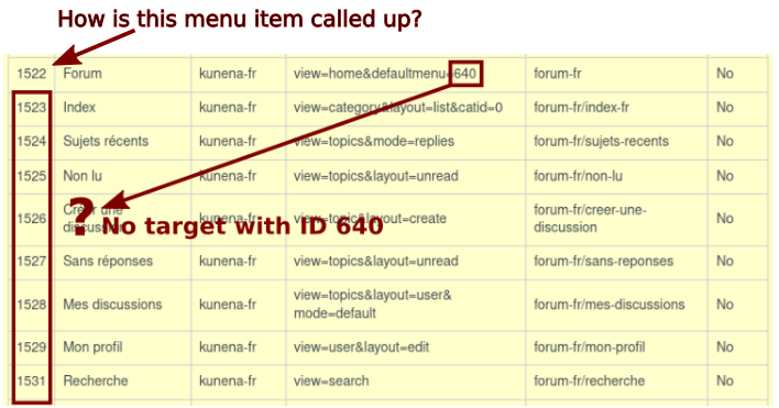

The menu item with the ID 640 is located at the top of your main menu. So the forum links back to the menu item at the top (image 2).

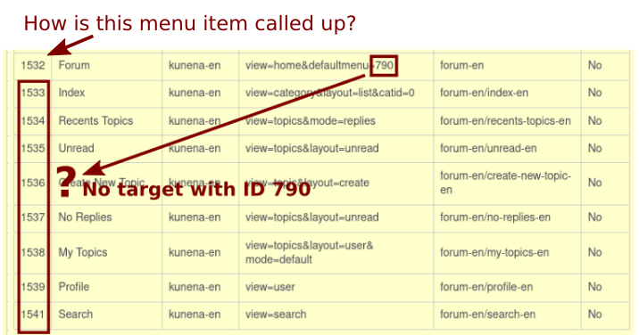

I can't find the Italian menu on your test page, but I assume it's the same problem (image 3).

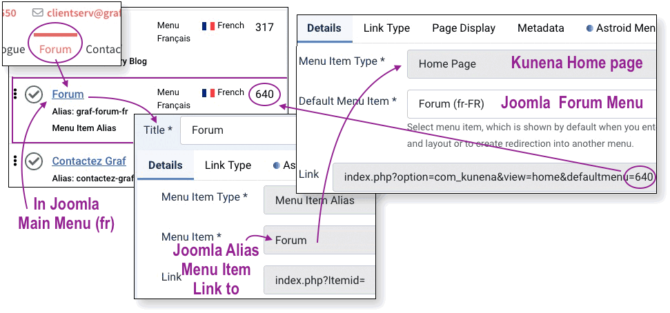

• FOLLOWING — This is 2 diagrams that show my menu construction:
The Joomla Main Menu item (fr)
The Kunena Menu item (fr)

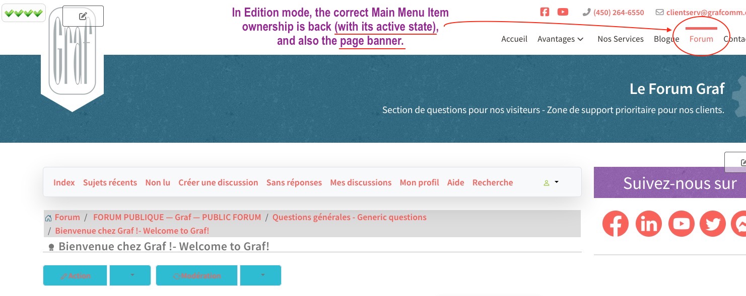

• In the forum Main Home, the Menu Item ownership is lost (no active state), and also the page banner?
— Curiously, in Edition mode, the correct Main Menu Item ownership is back (with its active state), and also the page banner.
In Edit Mode
In Forum Main Menu item
