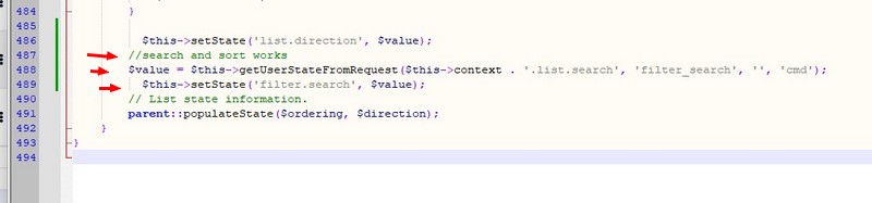

here locally as a test CategoriesModel.php I moved the lines below "$this->setState('list.direction', $value);"
I made some adjustments and now search and sorting etc. works here
ps
and Gindi's solution also works, see image search_and_sort_works2
ps
With kind regards
Leen

I have solved the problem differently.
I inserted the fix in row 474-475-476, between "list.start" and "list.limit".
Search and drag&drop work fine.
Gindi
Gindi

ha also tried your solution and it also works
With kind regards
Leen

In a test with K6.1.3.2 I added the fix above "list.direction" and it works.
gindi
gindi

I was just about to update my livesite to K6.1.4 and I checked the categories again before backing up and updating. I found that the search and drag&drop work there.
On the live site I have php8.1.23 and on my test sites php8.2.11active.
Can it be because of php that the search and drag&drop work there with K6.1.3.2?
gindi
gindi
