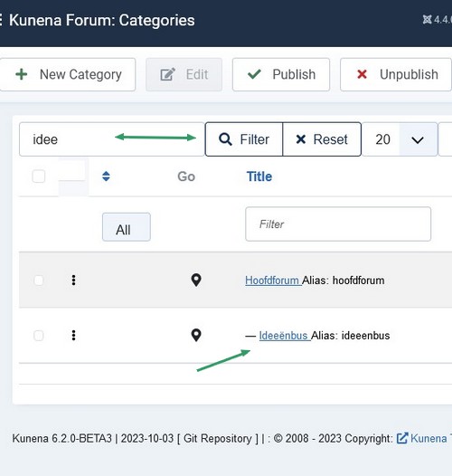

It looks like this fix also works in 6.2. I saw this fix on GitHub this morning and tried it locally
With kind regards
Leen

good to know, i haven't merged in time before the release the last changes made in K6.1 to K6.2
