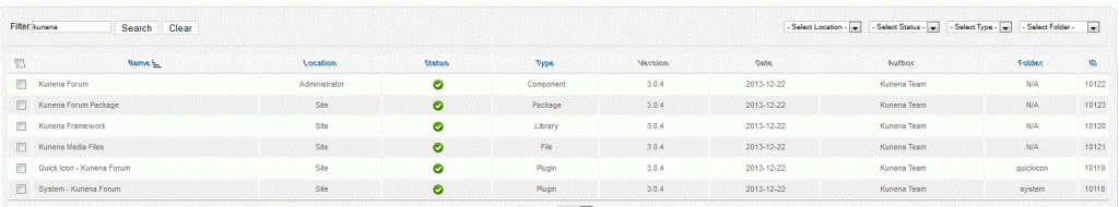

While Kunnena is trying to install itself, The Kunnena Forum, Packages, Framework and Media files don't have a folder (on old Kunena install the files were in Kunena folder )??? - see the capture
