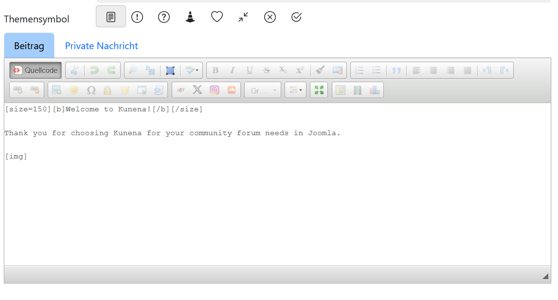

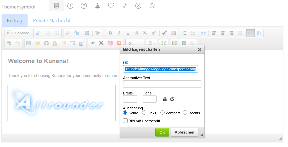

the image2 plugin in use:
but the (empty) resulting img code
