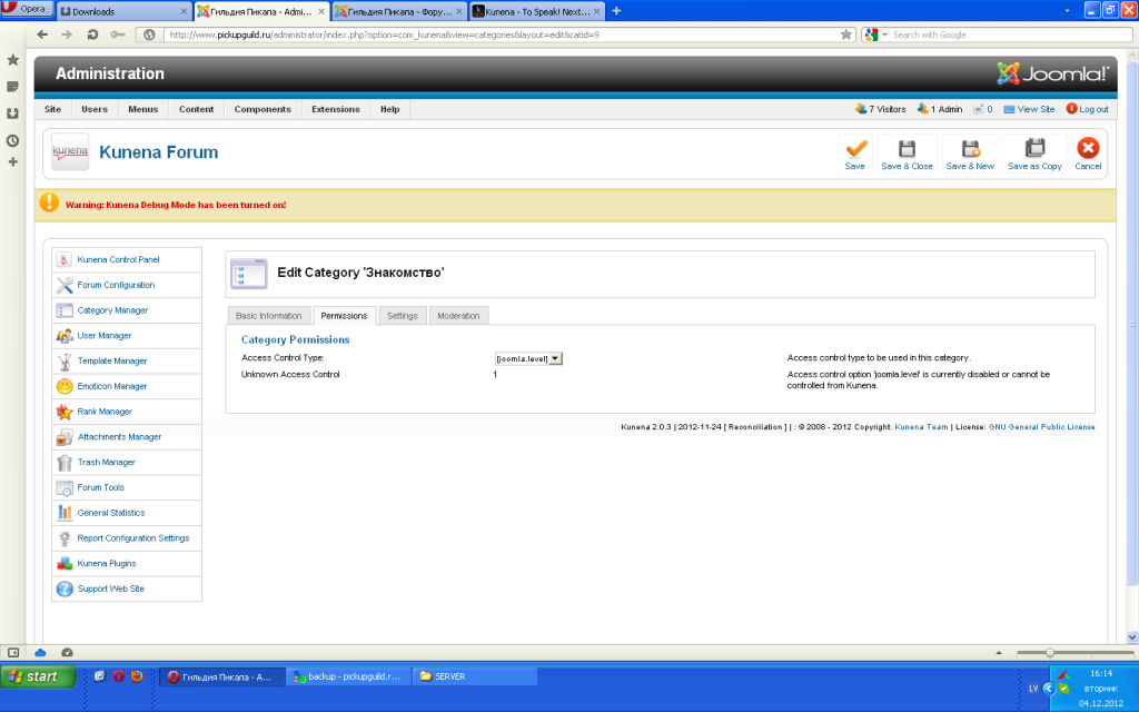

13 years 11 months ago - 13 years 11 months ago #137590
by regdomain
Replied by regdomain on topic Upgrade problems with K 1.x -> K 2.0.3 (and solution)
FAILURE
Attempt to upgrade from kunena 1.7.2 to 2.0.1 caused access rights problem to all categories. By default now joomla.level is selected and access is settled to 1 or 2 as unrecognized authorization method. Could not be changed. Upgrade to 2.0.3 did not fix the problem.
I gueass this is because of the latest core or jomsocial installed.
