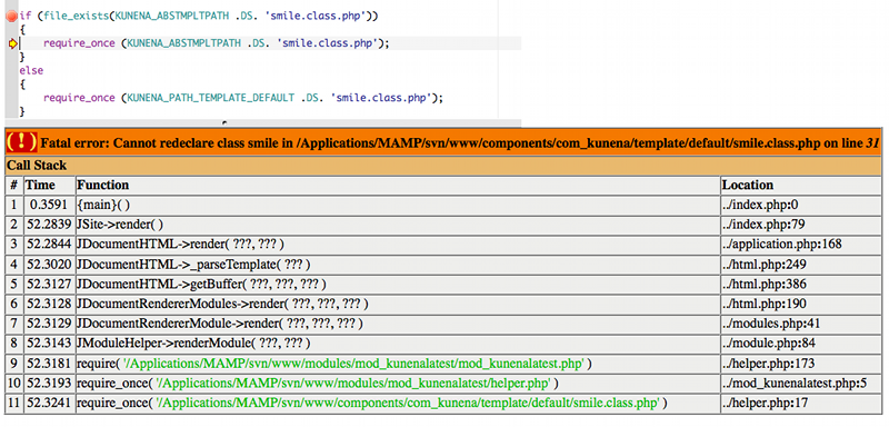

it hits this line in kunena.php, which is listed above:
require_once (KUNENA_ABSTMPLTPATH .DS. 'smile.class.php');
...it loads the custom smile.class.php from my custom template.
Then it gets to the explicitly declared hard-coded reference to the default template's smile.class.php and blows up with:
Fatal error: Cannot redeclare class smile in /Applications/MAMP/svn/www/components/com_kunena/template/default/smile.class.php on line 31
I get the fact that the distributed templates don't blow up - but none of them have a custom smile.class.php. There's quite a bit of display layer code in smile.class.php so I'm guessing it's possible I'm not the only one with a custom file in my template.
I also did a sitewide 'find | xargs grep' to look for all references to smile.class.php and it appears that the only references I have are
1. some config references in /administrator
2. the conditional you mention in ./components/com_kunena/kunena.php
3. ./modules/mod_kunenalatest/helper.php
4. commented header code in ./components/com_kunena/template/default/smile.class.php
and my custom smile.class.php
If there is a smile.class.php in a custom or modified template, line 17 in helper.php is going to have an issue.
Are you saying that the module is only supposed to work with distributed templates? I would think you could add your own conditional and basically make sure you're doing a require_once on the same smile.class.php file that kunena.php loads.
Never tried custom templates. Don't know that there are peoples which modifies smile.class.php....it loads the custom smile.class.php from my custom template.
OK, I will sync loading smile.class.php with Kunena. Will be resolved in next version.
