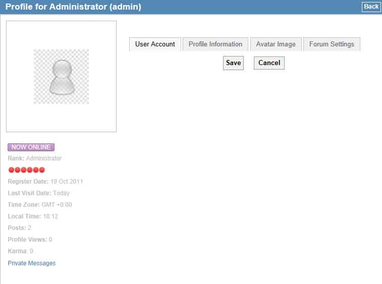

15 years 1 week ago - 15 years 1 week ago #109478 by NielsVolman
Replied by NielsVolman on topic Re: Creation of profile
I've got the same problem on my site www.fics.dds.nl/swtor_guild/index.php
Tried to fix it using jomsocial, but that doesn't allow the use of signatures which I would like.
I'm using Joomla 1.5.23 with Kunena 1.7.
When I don't use Jomsocial and tried turning the mootools on/of and that makes the "EDIT" button clickable/not clickable. However still can't edit the details like avatar, etc.
Last edit: 15 years 1 week ago by NielsVolman. Reason: added image of edit screen
