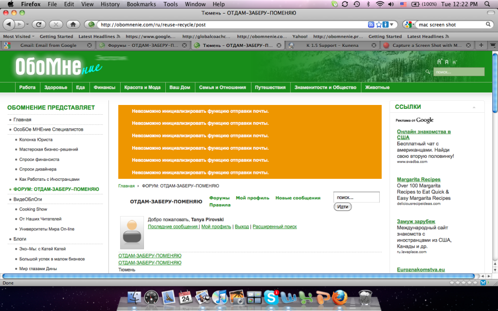

I've set up the forum with several categories and each category has a sub-category. The category posts are not pre-moderated, but the subcategory posts are pre-moderated. When I test, this is what happens:
(1) When I post in a non-pre-moderated category, I get a "cannot initialize the send function" (screen-shot attached although it is in Russian) yet the posting appears fine without a problem. However, I have it set to receive a note about the new posting as the moderator, but I receive nothing.
