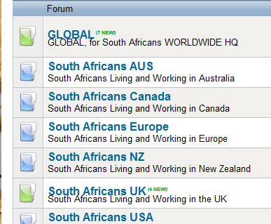

Hope this is the right place to ask.
In the categories view, any of them, if there is new posts the category title mixes up with category title.
See attached image.
URL: www.sapromo.com/saforums
Thank you in advance for any help or support.
See attached image.

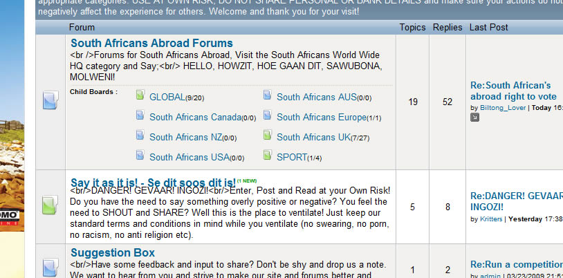

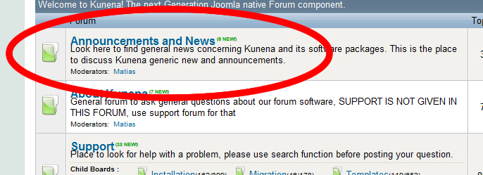

I have attached two images,
The first show display error in Kunena 1.0.8,
when unread messages in category it appears green, so the the category title and description is overlapping... screenshot from this forum to show it is not a problem just on my website
The second, is after upgrade to Kunena 1.0.9, the MAIN PAGE wont process the HTML code anymore used in description field... it worked fine in 1.0.8 and works on sub categories just not on main.
Any and all help appreciated
THANK YOU!
THANK YOU!
