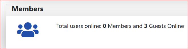

4 years 1 week ago - 4 years 1 week ago #226066 by Leen

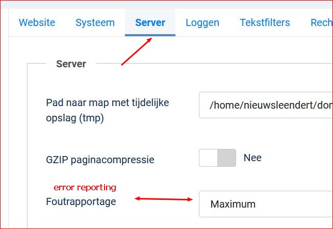

If you turn it off, clean cache etc.
And if necessary, also set error reporting to maximum

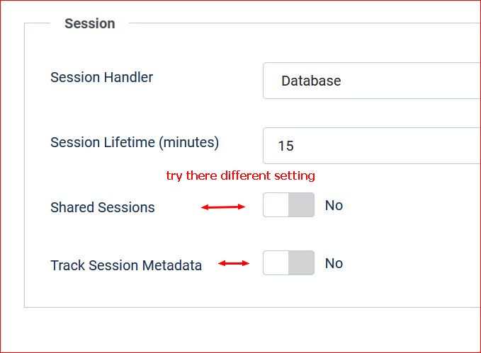

4 years 1 week ago - 4 years 1 week ago #226071 by Leen
with few tests it looks like it may come
by setting at administrator>Global Configuration>tab>system and then at the bottom at
Track Session Metadata No or Yes
Track Guest Session Metadata No or Yes
try there different setting in my test he kept user number.
looks like it's holding data if set to yes
Or he didn't count anymore.
Possibly in combination with JCH optimizer only got right again
by turning it off and Recount Statistics in kunena tools

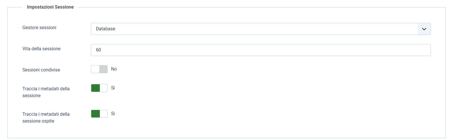

4 years 1 week ago #226072 by riffi67
Thanks a lot!
If i disable the shared session is working fine!!!
