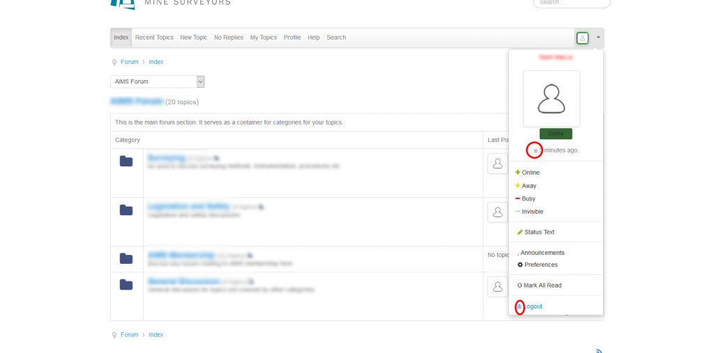

Also, back on the icons issue, I am still missing some like the icon-clock, pls see attachment.
