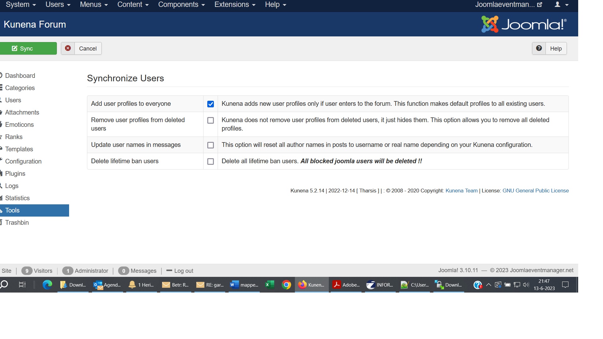

I lost the avatars when I ran the tool on a live site.
If I re-run the tool with the new file (the one from Github) will it retrospectively repair the avatars?
Just trying to avoid running into more troubles.. ;-)
3 years 4 months ago - 3 years 4 months ago #228344 by rich
I can't test it because I don't get this error, but go to /administrator/components/com_kunena/controllers/ and copy as backup the tools.php Afterwards remove the lines 341 - 361 then refresh your forum.
Last edit: 3 years 4 months ago by rich.
3 years 4 months ago #228349 by ernst67
Thanks Rich,
Unfortunately that did not work :-/
I tried both without and with this option checked:
The only thing that changed is that it now seems that the component and module (kunena Latest) are loading an empty avatar. Until now it was loading nothing (just a dot)
