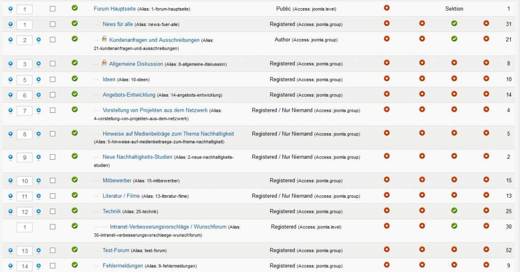

11 years 1 month ago #169191 by chris9044
Hallo Xillibit
I first would have to ask back if I could open a test-account, there's some sensible data in it. But in the attachement you will find the screenshot. I changed the "Test-Forum" in the Database from ID 12 to ID 52 and now it works. That was the only change I made. With ID 12 it doesn't work. That was the only thing I changed.
