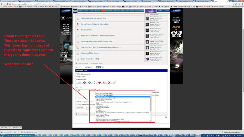

I opened a topic and I tried to merge it with a bigger topic.
That's the topic here:
www.gameworld.gr/forum/4-chat/148781-asteies-eikones#143946
When I clicked "Moderate topic" and tried to merge it with this topic...
www.gameworld.gr/forum/4-chat/1582-asteies-eikones-memes
The outcome was that I couldn't find it! There is a drop-down list with 30 suggestions and I can't understand why.
My "Chat" forum has 867 topics!!
www.gameworld.gr/kunena/4-chat
So why should I choose ONLY one out of those 30 topics from the drop-down menu? I don't want to. I might want to use any from these 867 topics and that's what must happen now. There should be a system where I could click "merge topic" and a screen of the subforum would appear, where all topics would have the option "Merge here". That's one of the very basic moderation tools which exist in every forum component.
So questions:
1)Are you going to fix that in the future?
2)How am I supposed to merge my topics now?

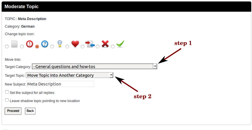

9 years 6 months ago #2 by rich
It requires no fix. This feature is already available.
Step 1. Target Category
Step 2. Target Topic
But the easier way is:
Step 1. Target Topic
Step 2. Manuelly Enter Topic ID (the topic ID you see in the browser address)
