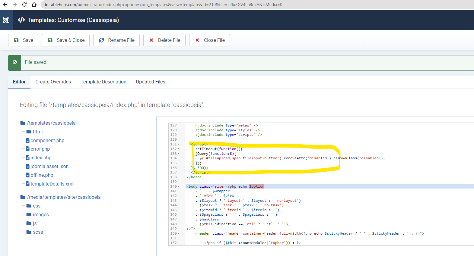

Ok Jchatsocial looked at my website and said
Hi Karl,
i had a look and found that actually it's not something caused by JChatSocial, it looks like a bug in Kunena Forum.
When the chat is on page the button is kept as 'Disabled' by Kunena even if there is no reason.
For the moment i've added a small script to the index.php of the Cassiopeia template to fix the problem, i guess you should report it back to Kunena.
Hi Karl,

<script>
setTimeout(function(){
jQuery(function($){
$('#fileupload,span.fileinput-button').removeAttr('disabled').removeClass('disabled');
}, 500);
</script>
