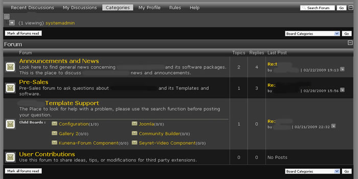

    Community Builder does not, at the moment, provide the ability to change a user's forum preferences and that, in my opinion, is more important. Consider this:
    Depending on the setting you choose in the Kunena configuration, will affect the target of the highlighted tab and the means to set forum preferences. I think it's worth taking time to experiment.
