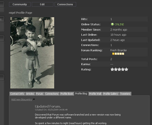

Yes that really is me 52 or 53 years ago! I wonder in the parrots are still alive!
