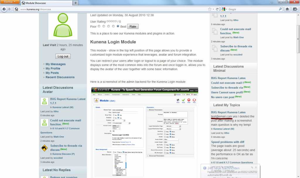

14 years 9 months ago #114499 by 82ab1c0b9105e9e4fd2ae19b
Please look at the picture above Bugreport4.jpg. In the showcase on the right side: Headline "Lastest My Topic" I made a red underline. Here is the test email adress not clickable. And I like to know why??? Why is it on your side not clickable? And on my homepage it shoot the template.
I think that modul is a kunena latest modul, or isn't it?
14 years 9 months ago - 14 years 9 months ago #114528 by sozzled
The reason that this topic has gone on for so long is because of the subject. We've been trying to understand where is the bug, where does this bug appear and what does this bug do. We have not seen this bug on your website (because you remove all the evidence) and so we do not know how the bug "shoots the template" as you describe things.
If you enter an email address, the email address is clickable in the message (displayed by the Kunena component) but it is not clickable when displayed by the Kunena Latest module. That appears to be normal.
No-one else has reported your particular "bug". Your "bug" does not exist here at www.kunena.org . I have tried to test the same thing at one of my test sites and I cannot reproduce your bug there, either. You are also using Kunena Search 1.7.0 and Kunena Login 1.7.0 and Kunena Stats 1.7.0; have you updated these things to their latest versions (as I suggested that you do 4 days ago)? Does that make a difference? You are using Community Builder 1.3.1. Have you upgraded to CB 1.7.1 and, if not, why not? Maybe your problem has something to do with uddeIM or AlphaUserPoints?
You ask, "Why is it on your site not clickable and on my homepage it shoot the template?" I don't know (a) why or (b) how it "shoots the template". It has something to do with your website and that's all that I know.

14 years 9 months ago #114551 by 82ab1c0b9105e9e4fd2ae19b
OK sorry for the circumstances I have made. In the meantime we found the problem...
The plugin emailcloak was aktivated. As it was deaktivated everthing is ok.
Perhaps this can help you to repeat the error and find a solution.
