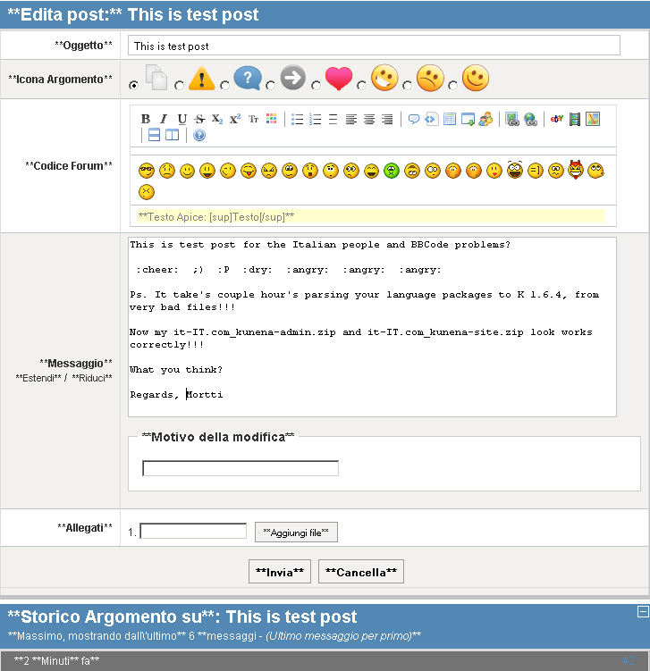

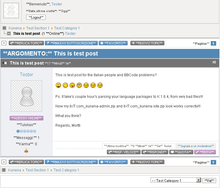

I take some couple hours to try find out your problems (I just compare/diff files from the K 1.6.4(en-GB) and it-IT files from the K 1.6.3 package...
Now after hours works (of the Italian language package) I can't see any error's with BBCodes anywhere. See test pictures also.
My little changelog can read here: docs.google.com/document/d/1vSv2NmUrkHI1...JstUH&hl=en_US&pli=1
I will send my it-IT.com_kunena-admin.zip and it-IT.com_kunena-site.zip packages to Matias Griese (K developer) if those help any Italian peoples? There is still a lot translation work todo.

Eheh, thank you Mortti, I've parsed it, too. As your version is better for sure, I hope we can see it soon here. While waiting I'm adding mine.
It seems that the problem was a ' char in the javascript code for the frontend and two missing " for the backend. I replaced the ' with the html special char. I've also added some missing strings.
Here is the working (I tested it only on my J1.5/J1.6 site) K1.6.4 Italian language package frontend/backend.
Thank you very much for your precious help.
