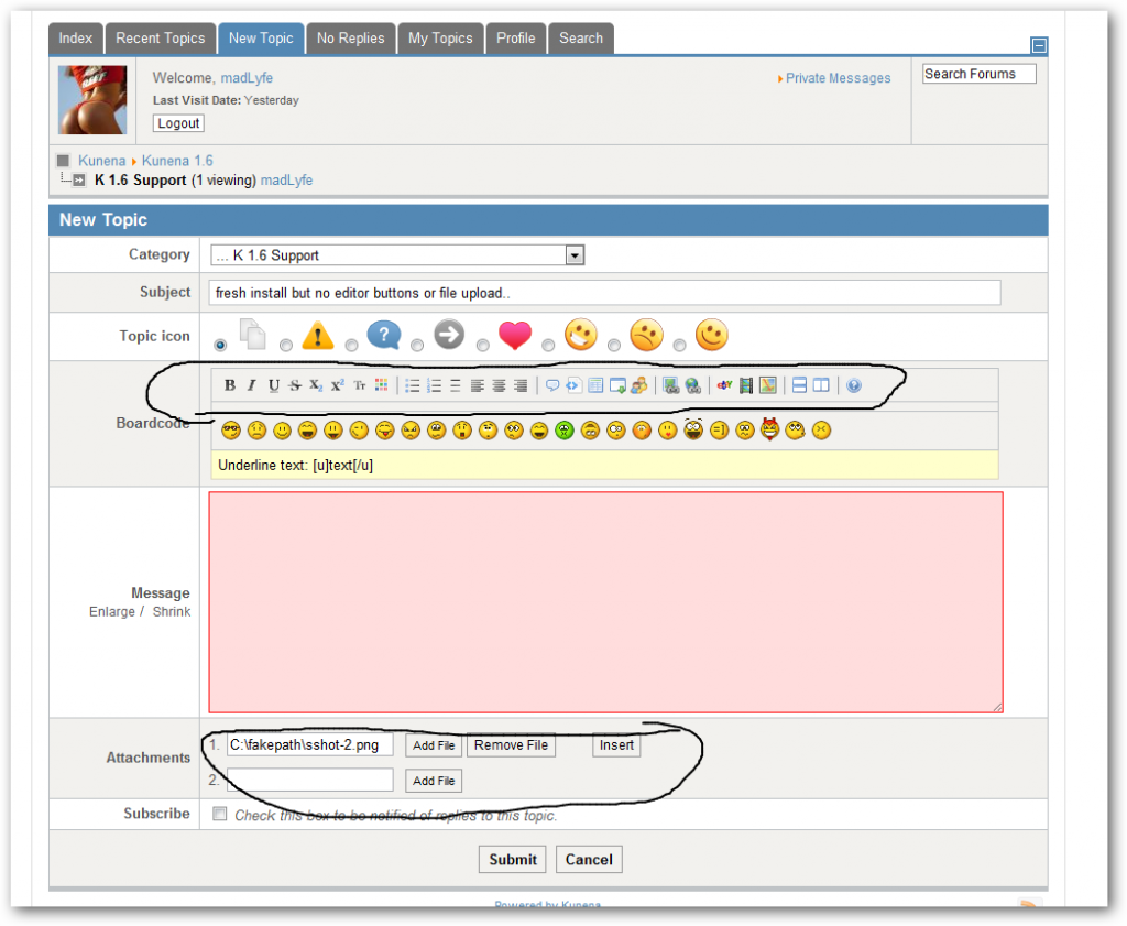

and here it is properly working on the kunena site:

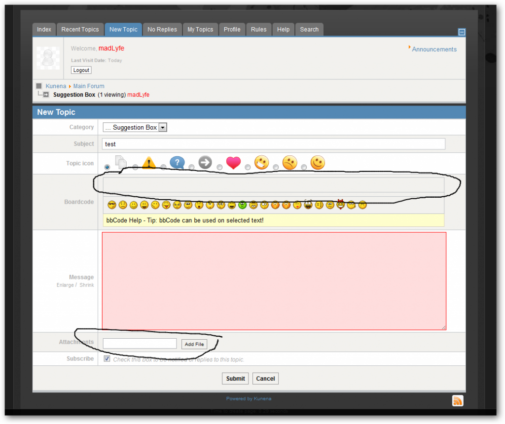

im sure this is just me being dumb, but im logged into my admin account on my site and have the file uploads set to 2mb(tring to upload a 1mb png) in the backend..

This is related to javascript.
