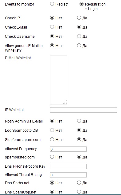

  5. Meanwhile i click on to www.stopforumspam.com at the security dialog but due to lack of knowledge, cannot move forward. Will appreciate the lead to what to do to get it moving eg where to put the codes and what are they? Unfortunately someone in this forum said it also won't work.
  6. Also thinking about using spmbotcheck plugin. Can this work?
