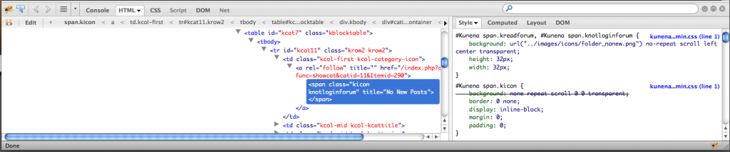

You can also use different images for each category. See Change category icons? for more information. I wrote an explanation of the process a while ago but the topic has now been locked. I will update the information here for others to read:
Category images can be customised: you can use different images for each category. The images, however, act as a tri-state indicator that show:
  • if you are not logged-in;
  • if you are logged-in and there are unread messages in the category; or
  • if you are logged-in and there are no unread messages in the category.
This means that if you want to customise icons for each category, you need three separate images, one for each of the abovementioned states.
To illustrate this point, I've created three example images (for those who know anything about rugby league, it also shows what my favourite football team is), as follows:
  • filename 36_notlogin.gif (for not logged-in)
  • filename 36_on.gif (for logged-in with unread messages)
  • filename 36_off.gif (for logged-in with no unread messages)
The general approach is to create three files: <catID>_notlogin.gif, <catID>_on.gif and <catID>_off.gif (where <catID> is the forum category number) corresponding to the three states I've described.
This same approach can also be extended to child boards: likewise create three images <catID>_childsmall_notlogin.gif, <catID>_childsmall_on.gif and <catID>_childsmall_off.gif. Obviously you should design these images about half the height and width as the images for the parent board.
These custom images need to be uploaded to ../media/kunena/attachments/legacy/category_images. The solution is independent of whatever Kunena template you are using.

I opened up listcat.php and changed all .gif-references to .png. Maybe an idea to add support in backend for other image formats in the future? :) With my png's this now looks really nice :)
