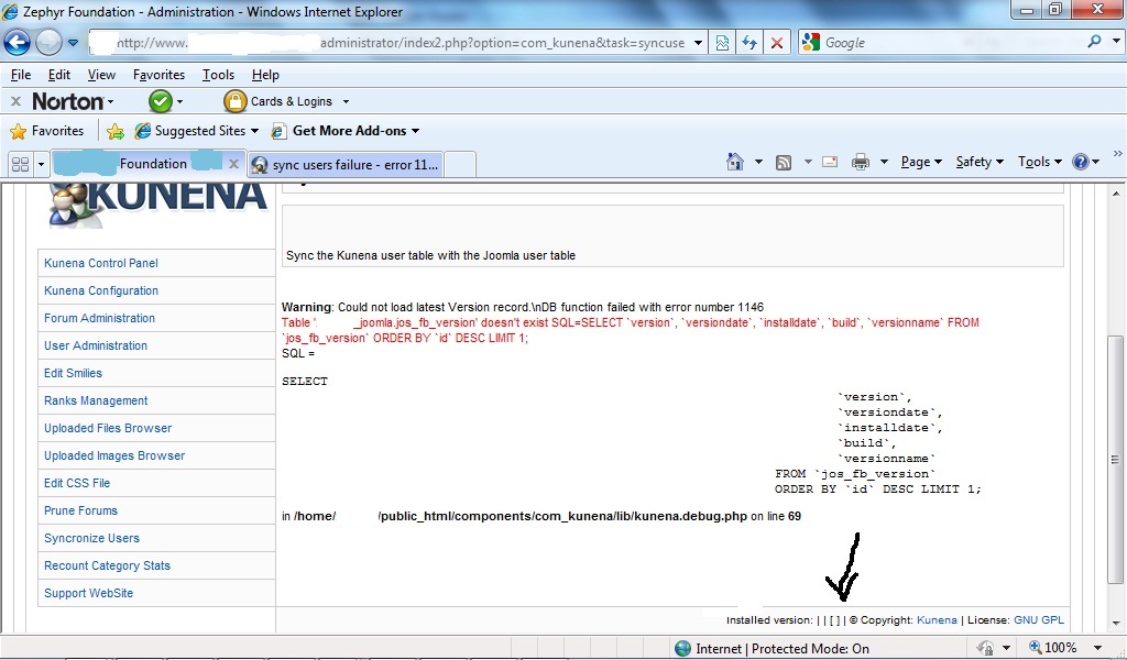

Have Joomla 1.5.13 with Kunena (only place I can see a version is at the bottom of the page: Installed version: | | [ ] - top of page says "Legacy 1.0" but does not identify product).

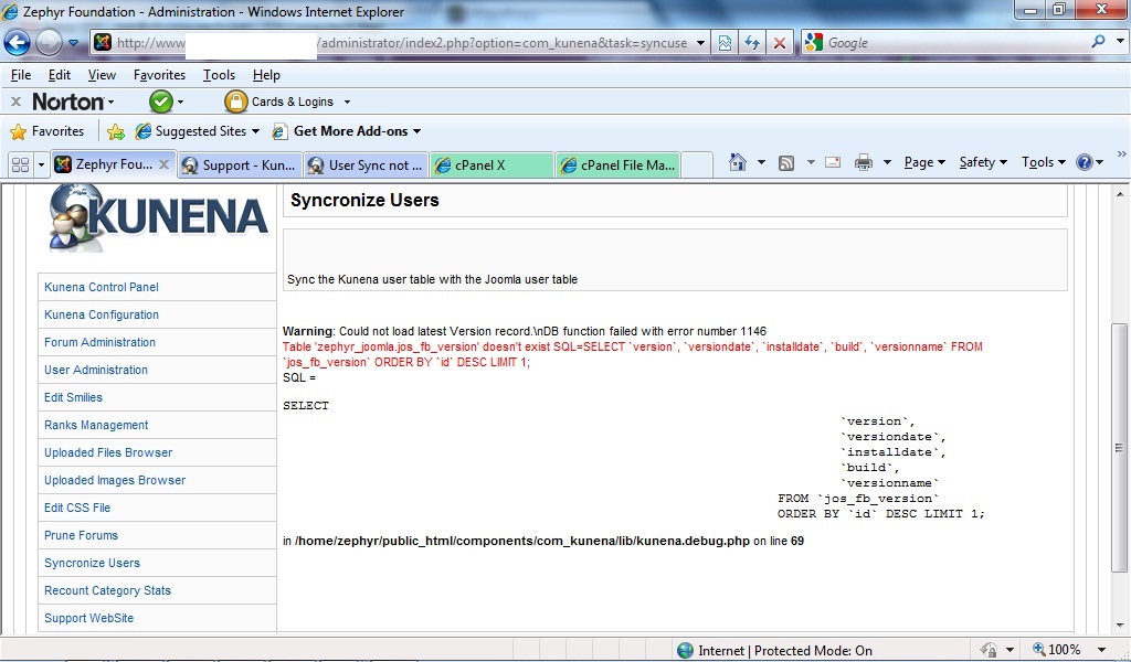

2. I also notice an error message that appears on almost every Kunena administration page and a sync users returns this same error:
Plus the version string on the page looks unpopulated to me and that the complaint is about version table. A missing table in the data base is fairly obvious but how do I get Kunena to create and populate the table? What could I do of reinstalling or upgrading Kunena to fix this problem??

Don't look into changelog to see kunena verion, you have one place to see the version, with the last element with the table jos_fb_version, it seems that this table doesn't exist.
