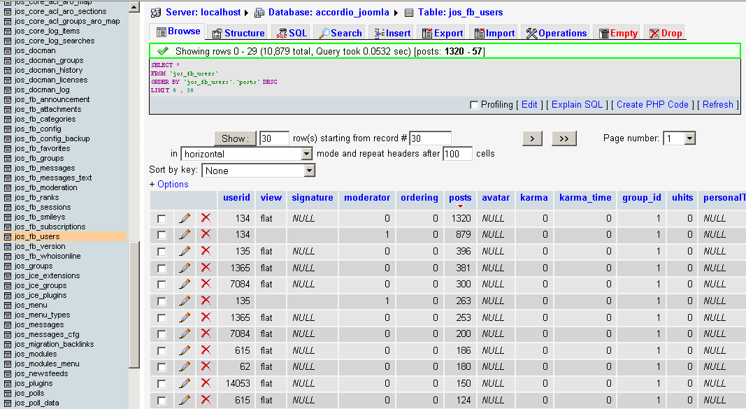

So I went to see the result. See the attached image file. This is jos_fb_users sorted by number of posts. Notice that now each user is in there twice (and with different numbers of posts).

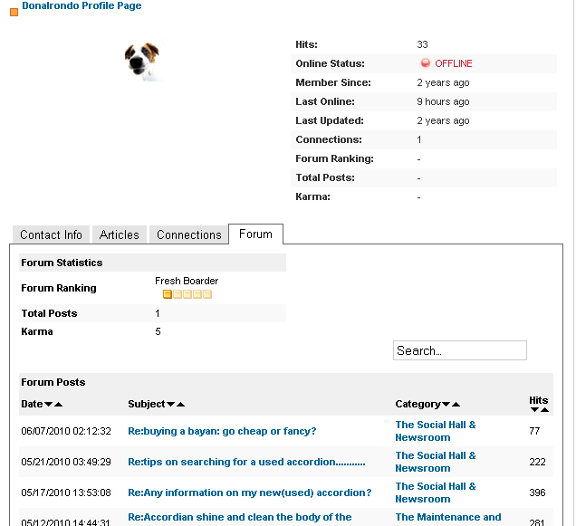

Also see the other attached file, which is the image of the forums tab of a member's CB profile in the front end. Notice how his many posts are all listed in the tab, but his number of posts in the header area is only 1.

16 years 5 months ago #49790 by JLW
I'm a novice at SQL but shouldn't that query have had some sort of update statement rather than insert?
