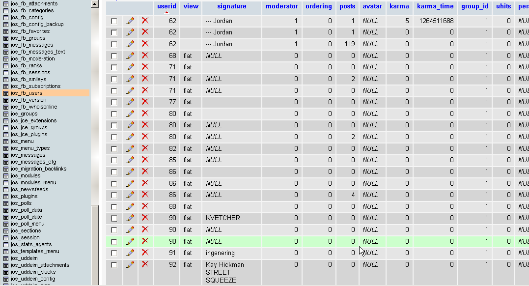

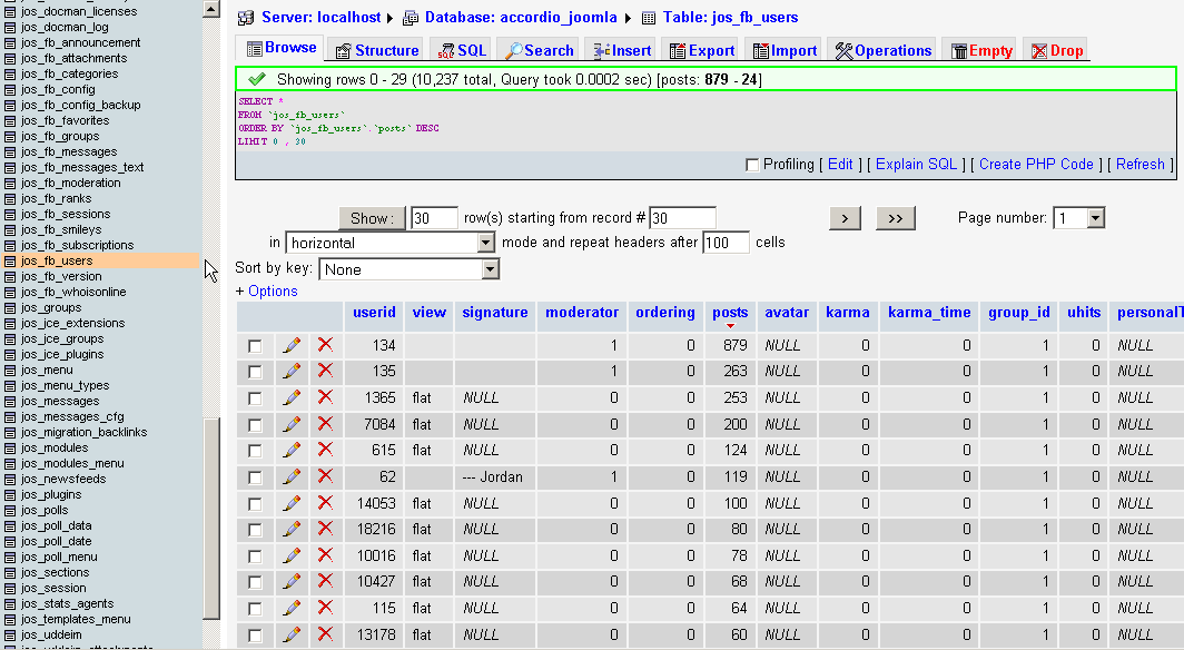

16 years 5 months ago - 16 years 5 months ago #49795 by JLW
I have restored the db to the way it was before executing that query.
Here is the same view of the jos_fb_users table, but as it was *before* the query:
Although we no longer see the duplicates that we saw after running that query, there are still problems:
The jos_comprofiler and jos_users tables are synched, with 1,567 records in each.
But the jos_fb_users table has 10,237 records, and sorting by userID shows that some users (including me, the super-admin) are in there three times: one time with the signature, one time with the karma, and one time with the correct number of posts! What do you make of this table:
What sort of query can clean this up?
[BTW, editing the signature in the front end causes all three records to have the signatures modified, so the three records then match in that field. That's how my records (#62) ended up with matching signatures. But the karma & posts data remain distinct.]

16 years 5 months ago #49916 by xillibit
Your table are no indexes is the reason why you have multiples similar items.
So, you need to re-do migration process a new time because now the tables contains broken datas.
Can-you create a clean install of kunena and compare the table indexes of this clean install and from imported datas ?
16 years 5 months ago #49941 by JLW
1.
What would happen if I manually (or via writing a php script) pluck the highest non-null karma value, the highest non-null post-count, and the longest signature string from each group of records with matching userid, and copy these into one of the records, and then delete the other two? Then there'd be no multiple records and no lost data. Would that clean up this problem?
2.
I'd like to not lose the new members and new posts made since the migration. Is there a way to save the new stuff and add it back after re-dong the migration?
3.
If I uninstall Kunena and drop all the fb tables, then do I install the fresh Kunena before or after using phpMyAdmn to bring in the old Kunena 1.0.5 files that are in my backup of the Joomla 1.0 site?
(And suppose I'd better inspect those old files first, just to ensure that they were not messed up from going from 1.0.0 to 1.0.5 already.)
16 years 5 months ago #49998 by xillibit
1°) I don't see the purpose of this, this thing is a bit uselless.
2°) 3°) The solution that i see, is to do a clean install of kunena in your local machine and import with phpmyadmin your existing datas (use the functions export/import). I hope that you not too much users, so maybe you can remove the duplicate items, then you can re-inject this on new fresh kunena install.
