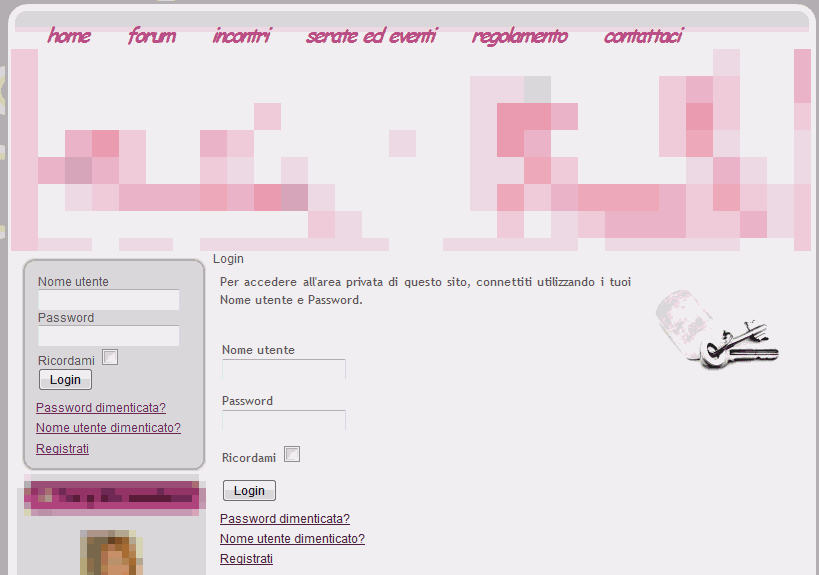

When a user wants to subscribe to Kunena forum the site shows two login modules, the core Joomla and the Kunena one, I just can't seem to hide one or the other but there must be a way around this, can you help? THANKS

Please show picture of your problem.
16 years 9 months ago #39946 by sozzled
Here is an edited picture of your website, Alistair. The login part on the left is created by the standard Joomla login module. The login part in the centre is created because you've disallowed public viewing of your forum. Which login part to you want to remove from this page?

We haven't disallowed public viewing of Kunena, try it yourself and browse through the forum as much as you like, you don't need to sign up to see it, but when you click sign up in Kunena (accedi) the unwanted login module in the centre shows up. Ta
16 years 9 months ago - 16 years 9 months ago #40010 by sozzled
Ah, OK. I see the issue now. Thank you for explaining the problem. When users click Accedi (= Login) they are sent to a page where there are two login forms. This is partly a Kunena problem and partly a web-design problem of yours.
Basically, you have defined the Joomla login module (mod_login) to appear on the page that the "Accedi" link refers to. That is the source of problem.
The problem occurs because of the way Kunena redirects users to the login function you have told it to use. It's complex to explain and the solution isn't easy. I suggest you search for login redirection , not because you will easily find a specific answer, but to give you some ideas.

16 years 9 months ago #40106 by Alistair
