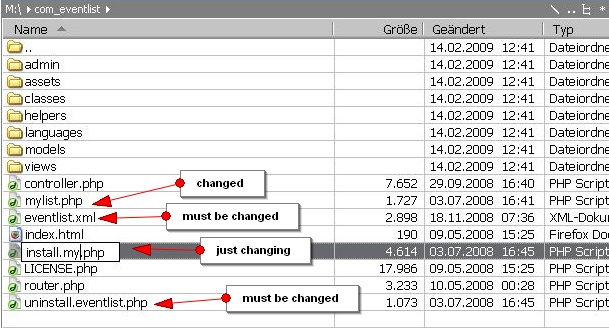

First of all i had to unzip the com_evenlist.zip in folder com_eventlist. Important!: If there are more zipped files in folder com_eventlist you have to unzip them too. Next i searched the string "eventlist" (without ") with notepad ++ in folder com_evenlist (important! take the options from screenshot below). Notepad is listing all combinations from eventlist, as Eventlist, eventList, EVENTlist and so on. This is a checklist for me, what i have all to change.

Ready? No :silly:! Next step is to open the folder com_eventlist with explorer, norton commander etc. and to rename the foldernames and the filenames, which contain the string eventlist (Eventlist etc). I have to rename those strings with mylist (Mylist etc). And of course the folder com_eventlist itself has to be renamed into com_mylist.
