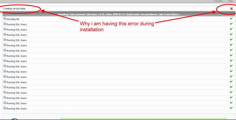

Hello There
First of all i would like to congratulate you guys for this Kunena component, it is amazing,
now come to the game.
i am having an issue during installation, as you can see in my attached image, some kind of Creating version table error
i am using MySQL 5.0.51-log and PHP 5.2.6 could you guys please guide me, what should i do
Thanks in advance

17 years 2 months ago #1338
by fxstein
Replied by fxstein on topic Re:Installation Issue
Is this a fresh install or an upgrade?
It seems the version table exists already on your system, but it might have been empty.
fxstein
fxstein

Hi fxstein
Thanks for your quick reply
yes this is fresh install, i was using Fb 1.0.5 RC2 previously and deleted all fbxxx tables from db, i also removed some old remaining FB directories from component folder, images folder, Administrator/components, but still having this issue, using joomla 1.0.5

17 years 2 months ago #1347
by fxstein
Question is: Does the component work now that you have installed it, irrespective of the version table error?
fxstein
fxstein

I had the same error .. what does it mean?

It means that the installer couldn't create the version table for whatever reason. If it was already there, the installer can't create it again which would cause this error. Did you previously use Fireboard? If so and you dropped the tables, you may have missed this one. If the forum works fine and that was the only error you received in the install, you should be fine.
