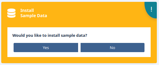

Install sample data (Optional)
  1. Go to the Joomla dashboard and install the sample data.
sample_data

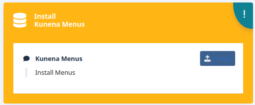

Create the Kunena menu
  1. Click on this button in the Dashboard, or navigate manually from the Dashboard to Tools -> Menu Manager
create_kunena_menu

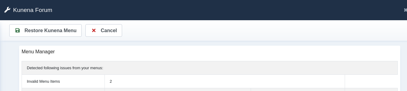

  1. Click on top the button Restore Kunena Menu
kunena_menu_manager

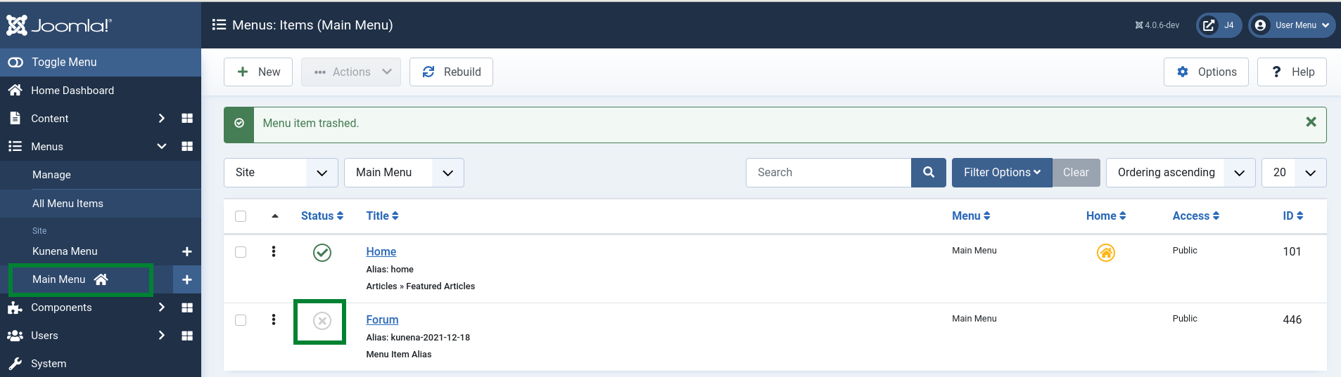

  1. Go to the main menu and publish the menu item created for you in your top-level/main menu.
publish_menu_item
