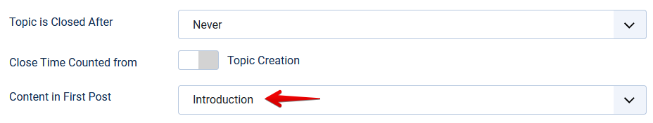

As a Note: The only reason I add the "Read More" Place Holder in the Joomla Article is so that the whole article does not appear in the Kunena Forum Topic. Without it, the Kunena Discuss "Content in first Post: Introduction" setting does not take effect.
