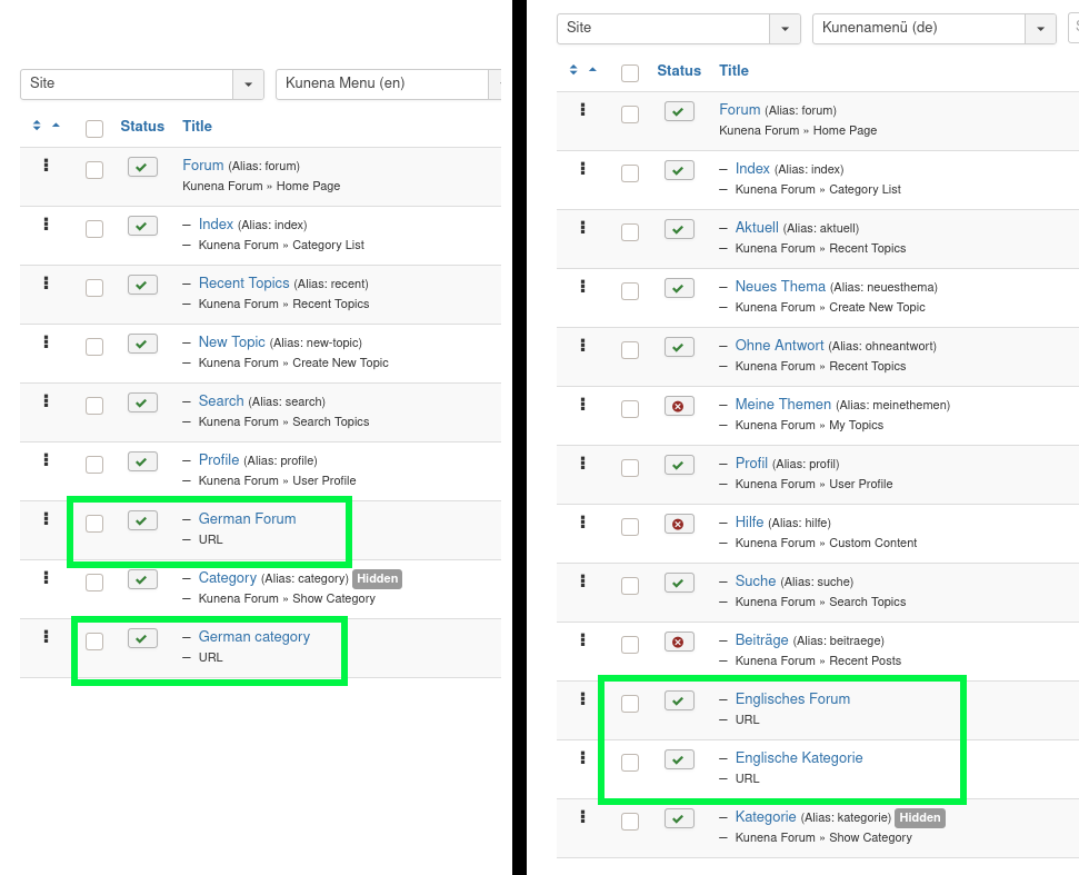

Furthermore, with this change toggling between the languages with the language flags does not work after this change, because one can't set associations when using system-Links->URL.
You don't need associations on this menu item. I'ts the same as when you click on these links. The association is correct.
terrazas-del-rodeo.com/es/foro-forum/
or
terrazas-del-rodeo.com/en/forum-foro/
Please let me know if you want me to change back to what you suggested for you to see its behavior.
I'm sorry, but these two menu items must be changed (as sugested), because these identical menu items must not be present in both menus. Your webpage is extremely slow, maybe this occurs by these wrong redirects.
I've adjusted my test page for you. It's indifferent if you switch with the flags or with the menu items, it always shows all menu items as well the content with the correct language. You can test it here: www.rich20.at/zwei_28321987-87234567-984...6743-776599/en/forum
In the picture you can see my menu settings.

5 years 7 months ago #217128 by rich
Everything seems to be correct now, except of the index.
I've decided to change /es/foro-forum/ to /es/foro/ and /en/forum-foro/ to /en/forum/ to make the URLs look better. It won't have any impact on the functionality.
Yes, it's indifferent, you can use what looks better for you.
I'm sorry, but I was not fit yesterday and forgot to write, in your case you need only either the index or the menu item to the category, because this shows the same content. I had published both, so you can see the difference between the menu types Category List and Show Category. With the category list you have at bottom the member list and statistics.
You can use the menu item that you like better (but also both).
You see both forums on the index page because the menu items have the wrong ID. On both menu items (en and es) are index.php?option=com_kunena&view=category&layout=list&catid=0
Must be as on the image. If Joomla the correct ID not accepted, you must empty the cache before assignment.
If the discuss error is still there after that, move the original (deactivated) Kunena menu to the trash before you remove it permanently. Empty the cache and check if the error is gone.
