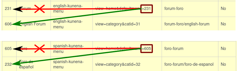

But I see in your configuration report wrong configured menu items. This can be leads to mistakes. Also, Kunena Latest has problems if menu items are wrong configured.
You run a multilingual website, so it is especially important that the menus are in order. The menu items marked in red must be changed to Menu Item Type = Menu Item Alias ( see here ).
I've tested it with this setting, but can't reproduce this error.

I didn't notice the bug immediately but saw it as I've visited your page.
en/forum-foro/english-forum
es/foro-forum/foro-de-ingles
both URLs goes to the category with ID 31
es/foro-forum
es/foro-forum/foro-de-espanol
Solution:
1. Fix the landing pages first as you have linked them to yourself. docs.kunena.org/en/faq/kunena-menu
The two menus (en and es) are separate menus, so these two menu items should theoretically be of the Alias type. However, this does not work within the menu items "en" and "es".
Solution:
Edit these two menu items and choose System-Links -> URL
Enter the URL en/forum-foro to the Spanish menu item
and to the English menu item es/foro-forum
If all menu items are correct, the error should be gone.
Hint: Create a database backup before, so you can undo everything if a mistake happens.

You have the same error as at the beginning. Go to your page and click on top the Spanish flag, then on Foro.The issue with Kunena Discuss is still there
Now click on the tab Foro the ingles, and you see that's not work.
Therefore, I had written:When I set menu alias for english-forum, spanish-forum, foro-de-espanol och foro-de-ingles, then the following error meassage is shown instead of the Kunena menu:
Rendering Error in layout Widget/Menu: Unsupported operand types. Please enable debug mode for more information.
Solution:
Enter these short URLs en/forum-foro to the Spanish menu item
